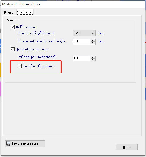

The generated codes are same when check or not check the button 'Encoder Alignment'.

My board is used to drive the motor on the wheeled robot with increamental encoder and hall sensor.I think there is no need to align the encoder when robot powered on. I just want to get the motor precise position to calculate the odometry of the robot. The encoder is used to speed close-loop control.

I've notice if the box is unticked you still have to call the align function however this doesn't mean the encoder needs to move to be aligned. When the box in unticked it is still necessary to call the function to align it however there will not be any movements necessary. Or another option would be to manually trigger the pin where you have allocated the encoder channel I.

I have compared these generated code, I found they are same whenever tick or untick the box.
