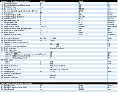

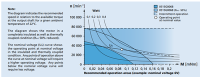

I'm using the IHM17M1 with the NUCLEO-F401RE for a low-power motor control application involving a 6V motor. The setup works well, but under load conditions (such as when the motor is underwater), the speed drops below the reference speed. However, the motor is not drawing its maximum rated current (1A); it's only pulling about 0.2A under load. How can I achieve maximum speed and torque for the motor under these loaded conditions?

The power board (IHM17M1) is currently drawing only 0.2 A. Could you help me understand why it isn’t drawing more current, considering the motor can handle up to 1 A?
