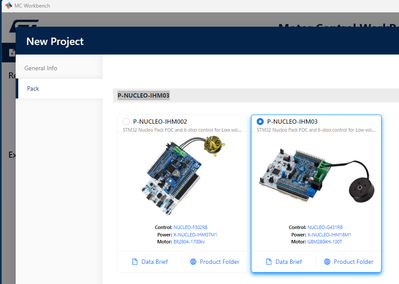

I possess the following items:
1. Development Board : P-NUCLEO-IHM03
2. Controller Board : NUCLEO-G431RB
3. Inverter Board : X-NUCLEO-IHM16M1
4. DC power supply 12 V dc

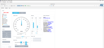

I downloaded the STM32 MCSDK 6.3.1 SDK as part of the environment setup, which is included with STM32CubelDE Version 1.16.1 and Motor Pilot_6.3.1 for monitoring purposes. Following the documentation's suggestion, I successfully generated the code for the specified hardware combination. After successfully building the generated code, I was able to flash it onto the controller. Upon powering up the development board, the motor pilot tool displayed the following status.
The status is triggered with FAULT_NOW with highlighting the following: Over Voltage, Under Voltage and Driver Protection.

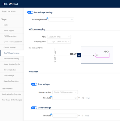

Hello @Prasanth91,
Using P-NUCLEO-IHM03 from WB 6.3.1
I have generated the code, and in Bus Voltage Sensing tab, you can increase the Over Voltage value to 14V (by default set 12V).
