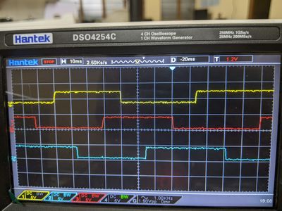

Could you please send a scope display of the H1/H2/H3 signals on NUCLEO-G474RE running the main=sto-pll - aux=Hall use case when motor is spinning (few cycles and scope channel - Hx signal correspondence)?
And also with main=Hall start-up?
2024-11-30 3:22 AM
Hello @GMA ,
Sure, Below are the snaps of the oscilloscope for the Hall Feedbacks.
Img1: Main: STO-PLL, Aux: Hall. This is while the motor is spinning

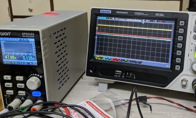

Img2: Main: Hall. (motor isn't spinning, hence no change in the Hall states. H1-1, H2-0, H3-1). Please note that the current is still getting drawn from the power supply as I mentioned about it earlier.
2024-12-03 9:06 AM
Hello @AkhilDP,
According to the scope, the "Sensors displacement" is 120°, is-it your used setting?

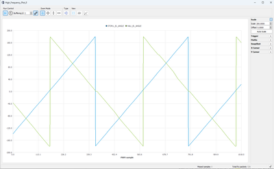

2024-12-04 6:02 AM
Hello @AkhilDP,
Coming back to your first trial figure, switching motor U and V phase signals I have the same result as you on your first shared plot:
If I understand correctly, HALL sensor signals have been modified to align both electrical angles, but it seems that motor phases were not correctly connected... Could you try setting H1,H2,H3 as on your first trial but using U,V,W phases to align both electrical angle?
2024-12-04 11:48 PM
Hello @GMA ,
As suggested we set our H1, H2, H3 as per the first trial and interchanged U & V. By doing so the motor spun in opposite direction and both 'STO_EL_Angle' and 'Hall_EL_Angle' followed the same pattern but weren't aligned. The Placement electrical angle had to be changed to get them aligned. But the motor still didn't run in Main:Hall Sensor Mode and behaved as usual drawing some amount of current without spinning.
Also, we tried with various other Hall and Phase combinations, but had not effect on Main:Hall Sensor mode.
