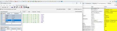

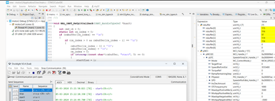

In 1st image 850 is received, in second image i sent 1000 it received 100

In your screenshot, the Docklight is obscuring important detail of the debug output - so we can't see what's going on.
