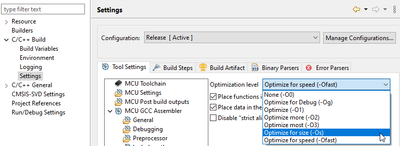

Yes, using the UART is important since it allows for controlling and configuring the application without changing its code, thanks to the Motor Pilot. However, the drawback of it its that it requires some Flash memory for the code and , for some devices with a little Flash memory it may be too much.
You can try to play with the optimization level by replacing -OFast with -Os as displayed below. However, you may have to lower the PWM frequency for the motor to spin with no error.
Best Regards
Fred
