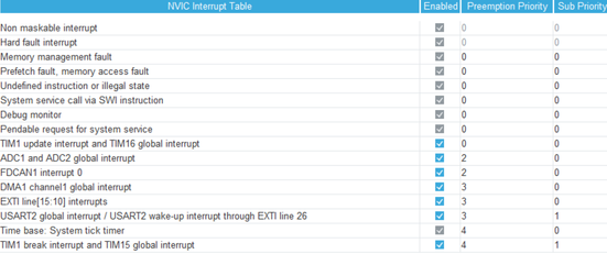

I am assuming it is a priority issue, which is set as
Any advice will be helpful.

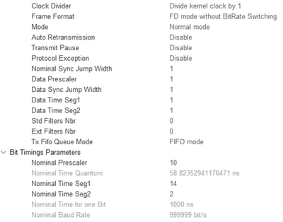

Update : FDCAN also works, so anyone who tries to use FDCAN,
my setting is (for 170MHz clock)
I don't know what's wrong with DMA really.
2023-07-06 4:29 AM - edited 2023-07-06 4:30 AM
Regarding your FDCAN bitrate config, I see 999999bit/s. So please try to find another values for NSEG1 and NSEG2 to have exactly 1000000bit/s (1Mb/s)
2023-07-06 5:17 AM
I cannot imagine that 1ppm deviation of the FDCAN bitrate is the problem here...
