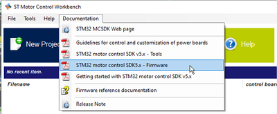

Please go through the user manual documentation:
APIs are described in "4.2 Motor control API" chapter.
