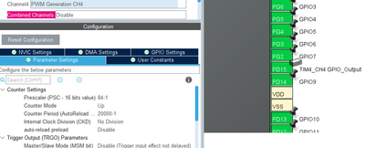

Next, I try to configure PWM for this pin:
1. Enable pin stacking for this pin since I need this pin to be GPIO_Output (to configure Open drain mode) and I need to configure TIM_CH4:
With this configuration, I can confirm that the PWM is working as expected but the voltage only goes up to 3.3V. Could it be that when setting a pin to TIM4, it disables the open drain mode?
In my main.c I simply do:
TIM4->CCR4 = 6000;
HAL_TIM_PWM_Start(&htim4, TIM_CHANNEL_4);
2024-02-06 5:28 AM
UPDATE:
I have discovered that when setting the pin to TIM4_CH4 while pin stacking is enabled automatically disables GPIO_Output and vice versa.
Perhaps these two are not compatible with each other and not possible to use both at once? Is there any workarround to generate 5V pwm?

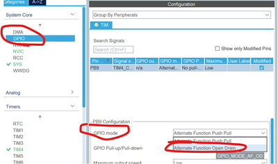

2024-02-06 5:41 AM
Well, just stop clicking in CubeMX, and set up the pin in GPIO yourself.
You want to set it to Open Drain in GPIOx_OTYPER, while set to AF in GPIOx_MODER and the proper AF number selected in GPIOx_AFR[].
There may be some way to coax Cube and/or CubeMX into doing this; I don't use them.
Note, that the rising edge's slewrate is dependent on the parasitic capacitances of connected pins and track, and the pullup resistor.
2024-02-06 6:00 AM
A pin can't be TIM4_CH4 and a GPIO output at the same time. How would that work?
You can set it to be open-drain and TIM4_CH4 if that's what you're after. Set it up as TIM4_CH4 and change the mode to AF_OD in the GPIO tab.
2024-02-06 6:40 AM
You are totally right! I was under the impression that the Gpio mode open drain setting is only available if the pin is configured as GPIO Output, but that is definately not the case.
The pin can be configured as TIM4_CH4 and still configured the Gpio mode as you have suggested.
I can confirm that by setting the mode to alternate function open drain I can generate 5V pwm
