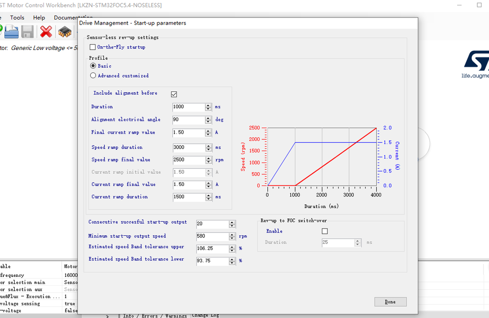

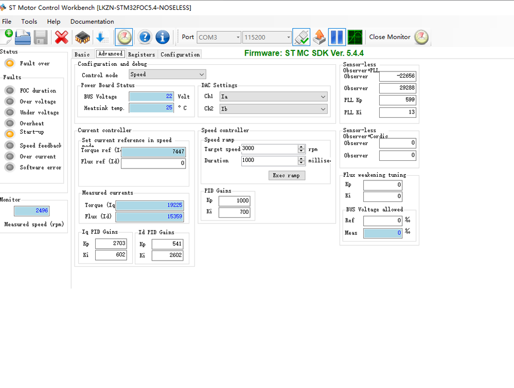

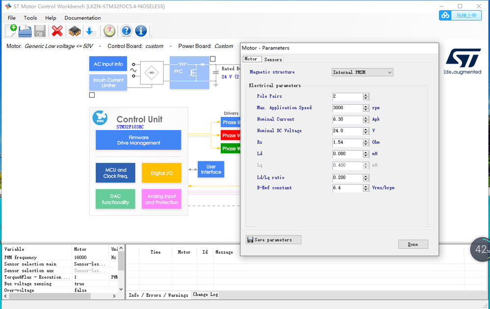

HI,Cristiana , My configurations were setted according to the pictures belowed, but the motor always stops after rotating for a while.
2020-11-02 6:49 AM
Hello @Wzong.1,
it seems a problem related to a start-up procedure failure (orange led in figure 2222).
With reference to "Drive Management - Start-up Parameters" window (Figure 3):
My suggestion is to make a fine tuning of the start-up parameters:
Moreover, please check if the all the Motor parameters (Figure 2) has been correctly updated.
In particular the pole pairs number is directly related to the actual motor speed (higher number of pole pairs, lower speed).
Let me know if you got the motor running.

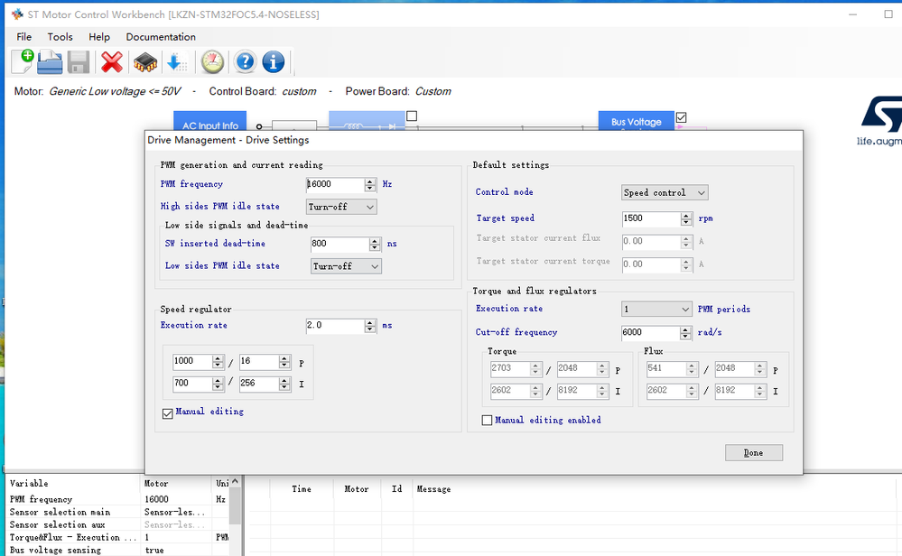

Also, by checking the other parameters I can suggest to try some changes in the "Drive Management - Drive settings" (Figure 4),
in the Speed Regulator section (bottom left side) use the following data:
You can try with these numbers and then make a fine tuning.
Also, the target speed (top right side) is much lower than the final speed set in the start-up.
If this parameter is the right one, reduce accordingly the Start-up parameters as above mentioned in my previous reply.

Hi Cristiana , in the following picture the Minimum start-up output speed suggest 15% maximum application speed
,while you suggest it should be close to the nominal motor speed, so I have no ideas.
