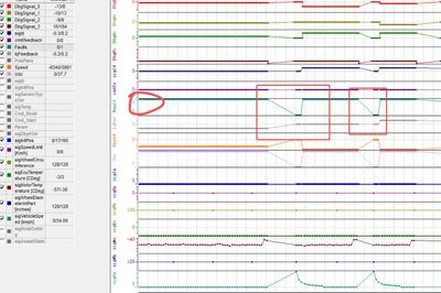

After disabling the VDS monitoring protection function by setting the SCREF input to VDD, I drove the motor and found that the motor has been shaking continuously. This issue has remained unresolved. Every time I replace a new MCU or controller, I only perform power on/off operations, and after about 20-30 times, a VDS fault is directly reported, with the fault bit set to 1. I'm not sure why this is happening yet. Could you please provide some guidance? Thank you
2026-05-07 6:10 PM
You can see ,the fault vds is contiune show 1 while i perform power on/off operations.
2026-05-07 6:11 PM
