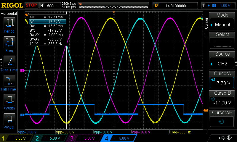

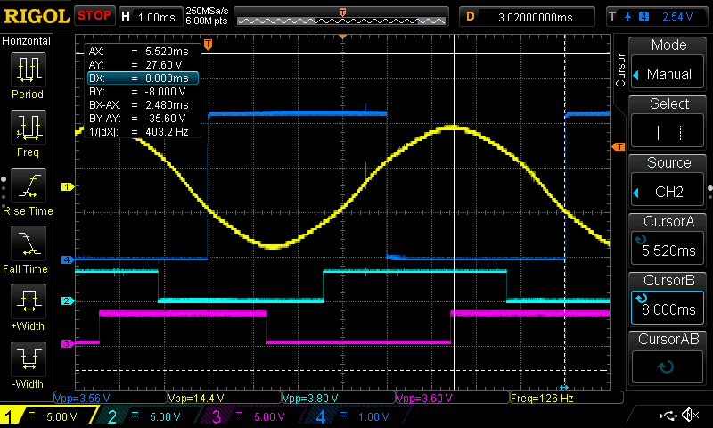

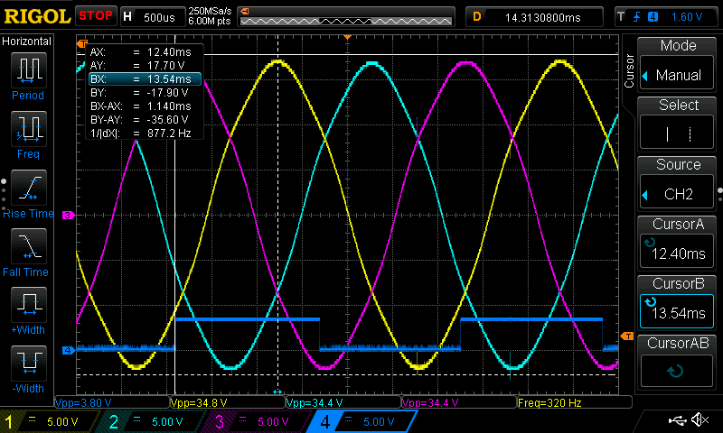

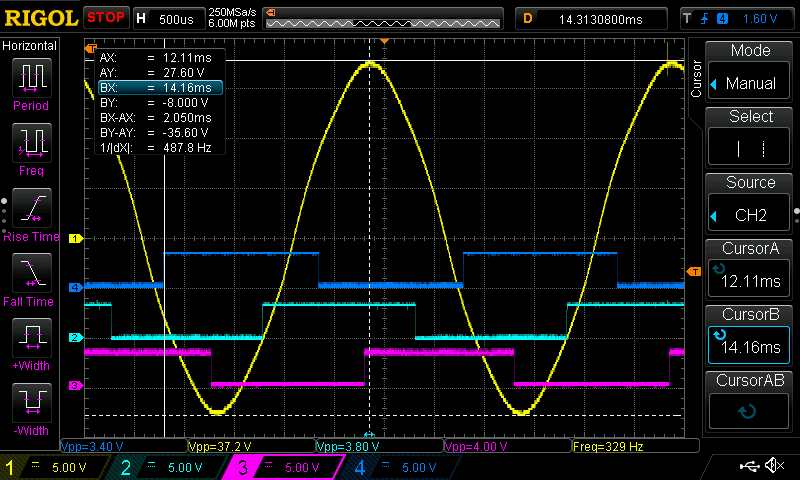

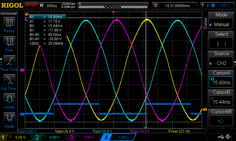

Well I was sure I had done this measurement before (after all this is how I calculated my kV, but only with one phase), I could not find any of my old information, so I repeated the measurements today.
Three phases (P1: Yellow, P2: Cyan, P3: Magenta) and H1Three phases (P1: Yellow, P2: Cyan, P3: Magenta) and H2
Three phases (P1: Yellow, P2: Cyan, P3: Magenta) and H3
Three halls (H1: Blue, H2: Cyan, H3: Magenta) and phase 1 (U/L1/P1)
Three halls (H1: Blue, H2: Cyan, H3: Magenta) and phase 2 (V/L2/P2)
Three halls (H1: Blue, H2: Cyan, H3: Magenta) and phase 3 (W/L3/P3)

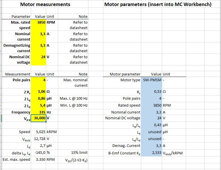

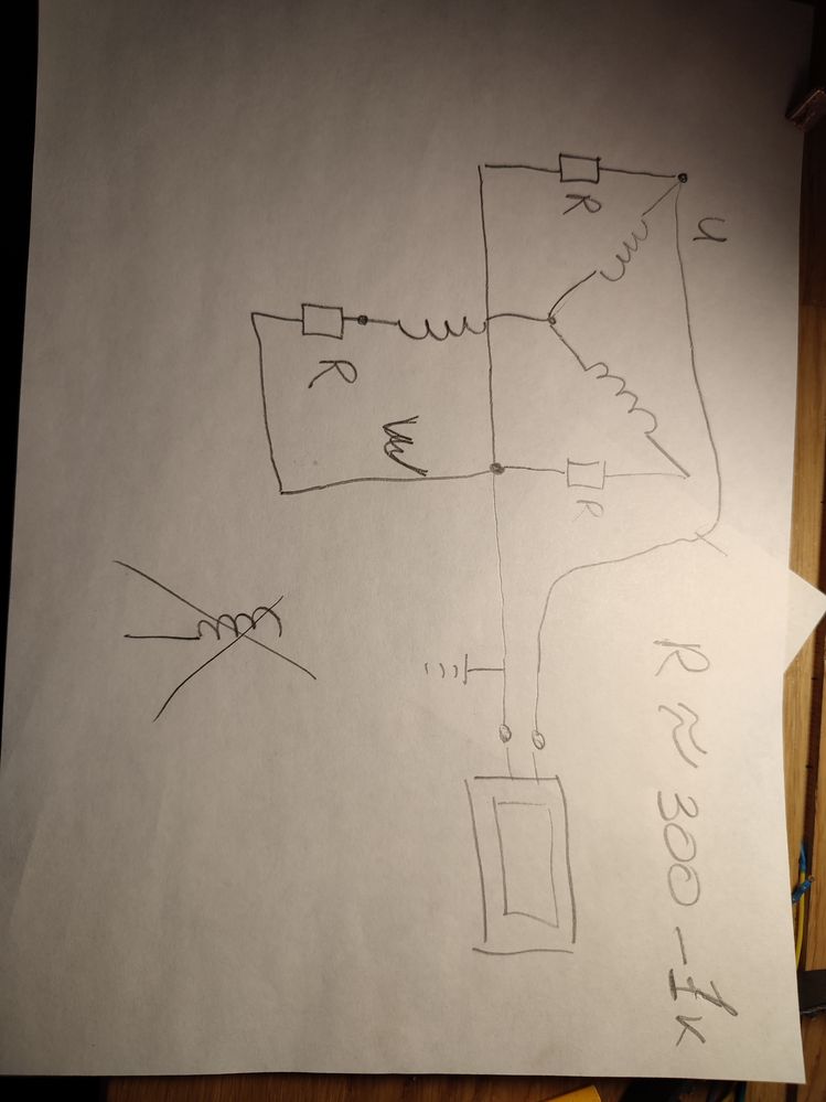

I used the motor calculator from ST to calculate the kV which turns out to be this time 2,53 Vrms/kRPM (I had a value closer to 4 last time, not sure if those resistors to form the virtual ground have an influence in my measurement)

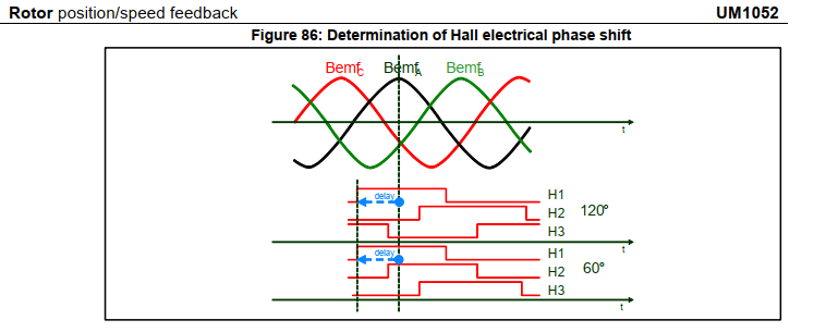

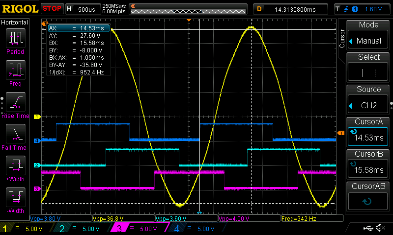

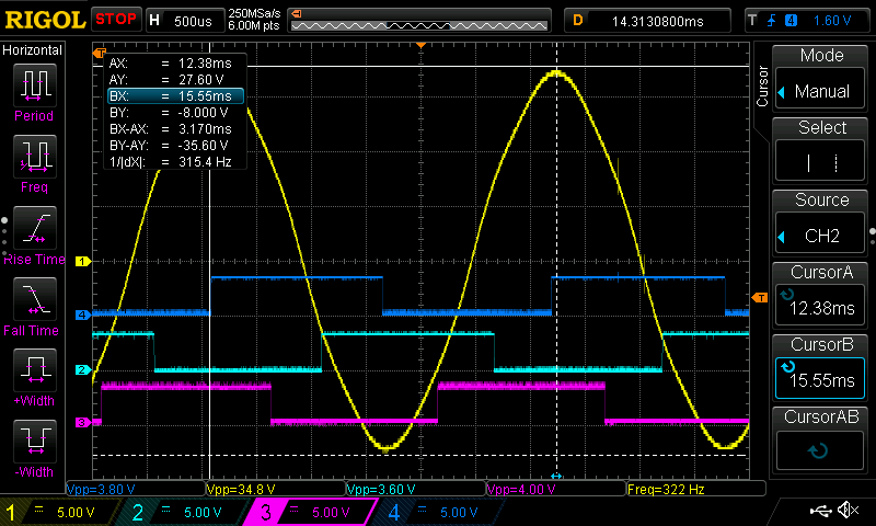

Still I don't get it, reading the post that you linked and having the following measurement (where P1: yellow, H1: blue, H2, cyan and H3 magenta):
I understand that the "placement of electrical angle" should be ~75° (if I consider that each division is around 30°).
However this picture from the UM1052, tells me that the angle should be around 155° :dizzy_face:
2022-03-26 1:49 AM
Hello, sorry for the long silence. Set the angle to 240 degrees.
2022-04-26 6:14 AM
Nothing to be sorry about, I greatly appreciate the time you are taking helping me out, however, could you explain me how did you come up with 240° ?
