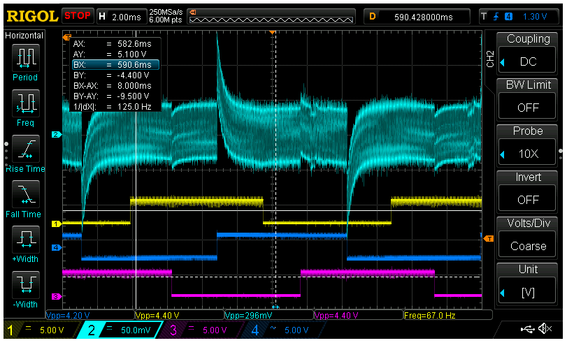

I keep investigating why I have problems driving my motor with negative speeds.

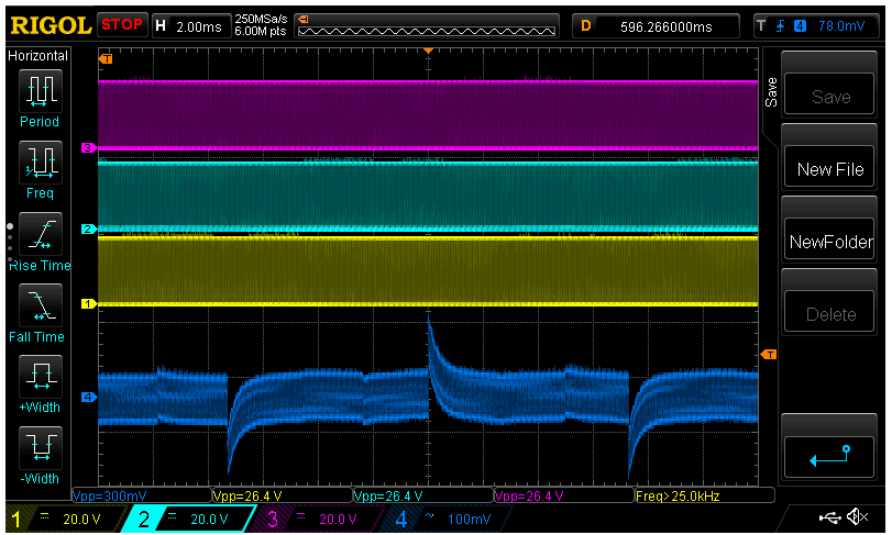

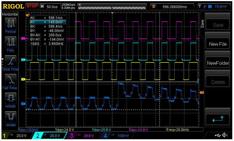

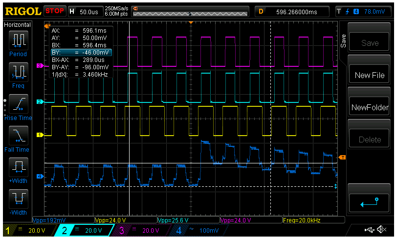

I captured the phase voltage directly on the motor leads (yellow, cyan and magenta channels) and the current on the DAC output (Ia or Ib) and I noticed this peaks on the current waveform.
Zooming in, the currents themselves don't look bad at all
However I do not understand where does peaks are coming from
Any ideas will be greatly appreciated.

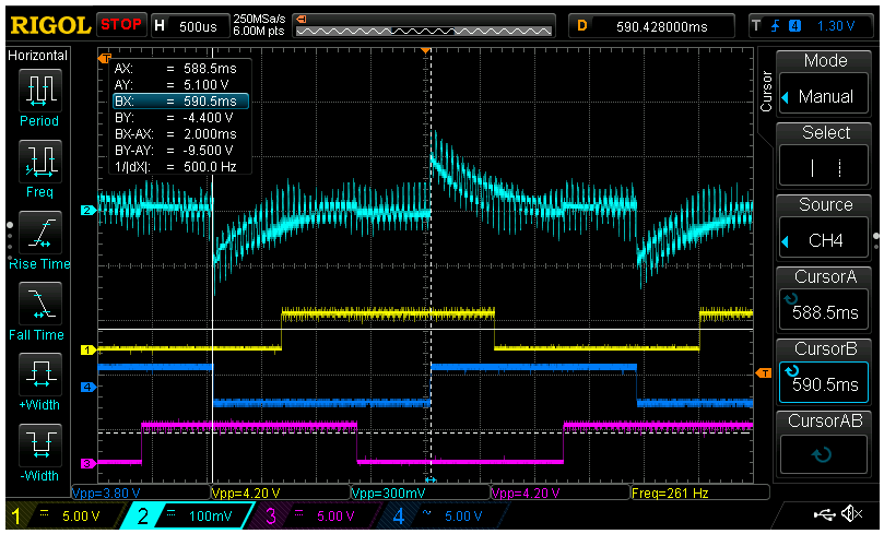

2022-02-02 1:41 AM
Apparently those peaks in my current signal are somehow correlated to the switching of the hall sensors, instead of measuring the voltage in the motor phases, I measured the hall sensor signals and the output of the DAC (Ia or Ib current) and those peaks appear exactly when the H2 (on the J3 header of the IHM08M1) switches.

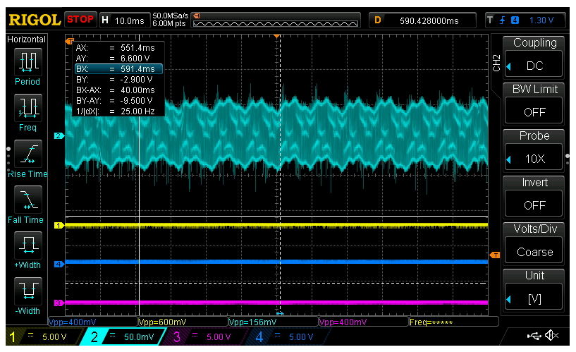

2022-02-02 7:04 AM
I created a new dummy project using a sensorless approach, but still with the hall sensors connected to the board, the strange waveform is still present
However, when I disconnected the hall sensors from the board, the waveform looks quite different:
Now I am a quite confused why this can be happening...
