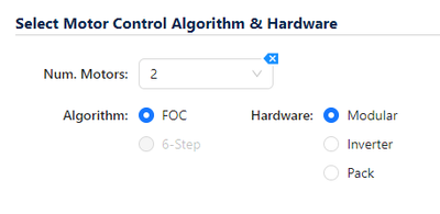

According to my understanding the MCSDK can support maximum of 2 motors.
