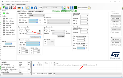

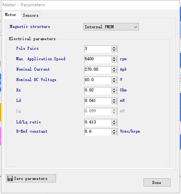

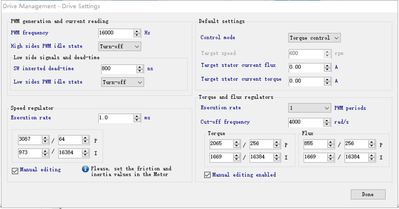

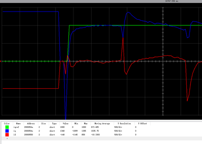

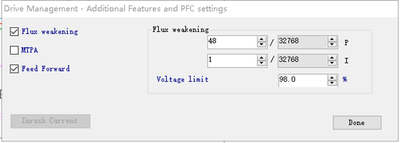

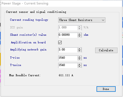

MCSDK5.4.8版本 相最大电流270A,采样电阻0.0009欧,Lq 0.0991mH,Ld 0.04115mH,定子电阻0.01974毫欧,三电阻采样,相电流采样放大倍数3,电机相移角295度,PWM 16000Hz, 扭矩环调参后电机轴抱死,无法启动。

Have you tried reducing the gains? Have you tried X-CUBE-MCSDK-6?

BMS128-60H Motor(Hall) | |||||
| 示例 | 参数值 |
| 示例 | 参数值 |
voltage platform |
| 60V/72VDC | rated power |
| 1.5kW |
peak power |
| 4KW | rated torque |
| 4.1N.m |
Peak torque |
| 45N.m | peak current |
| 270A(45Nm) |
Max.speed |
| 5400rpm | Ke |
| 8.63V/krpm(线反电动势有效值) |
POLE_PAIR_NUM |
| 3 | Lq |
| 0.09991mH |
ld |
| 0.04115mH | Rs(line) |
| 19.74mΩ |
Max.fwcurrent |
| 212ARMS | 温度传感器型号 |
| MF58-503F3950 |
Max.power |
| 4kW | Max.torque |
| 45Nm |
| rotational inertia |
| 2.6g.m2 |

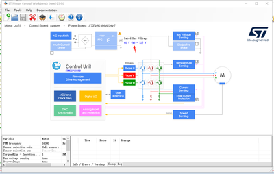

Motor parameter
Workbench:

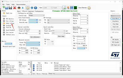

test

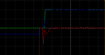

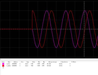

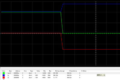

1 first start status under voltage
2.clear the fault next start
motor Vibration status Run is not faults
Stop-> next start: motor is not rotate
Open loop motor Normal rotation
I use STM32F103RBT6, 64MHz, the above problem occurs, how to find the problem point?
