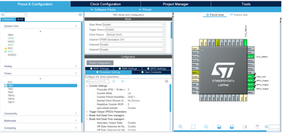

2023-07-04 9:57 AM - edited 2023-07-04 1:54 PM
I don't think I understand. From the documentation (namely the main document for STSPIN32F0A) I read, that TIM1 is primarily meant to produce PWM signal to control the MOSFETs. I am not sure what you mean by tampering with the timer. I also do not know what you mean by 'WB'.
The documentation (RM0091) mentions nothing about 'secure mode', I also do not believe deadtime should be necessary, since I am only using one channel of the timer TIM1.
I tried to attach the cubeMX .ioc file to provide some insight into my plight, but there is some issue with the file extension not matching the contents of the file, so I can only attach a screenshot of the pinout settings.
Thank you for your help,
Martin K. (aka Kalamar1)
