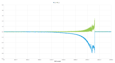

I also tried running in Open Loop mode, testing various values of current-control Kp and omega_i. The motor does run—sometimes faster or slower depending on the tuning—but after some time it still triggers the “Over Current SW” error.
I am not very experienced with Open Loop current control PID tuning, especially for HSO. Could you provide some tuning guidelines that are specific to HSO so that I can at least run the motor reliably in open loop?

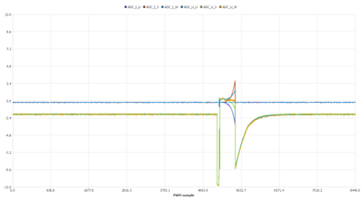

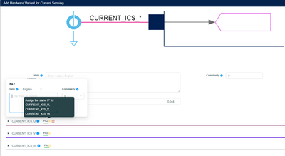

Regarding hardware: I’m using multiple ADC units (ADC1, ADC2) for U, V, and W current sensing. The STMC designer warns that all three phase‑current channels should ideally come from the same ADC. Could this be contributing to the issue, especially in HSO mode?
For PLL-based control the same board works fine, likely because only two phase currents—both from the same ADC block—are used.

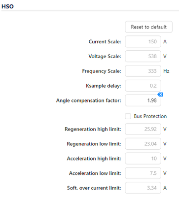

As of open loop, I advise to first use it to check that the target current is equal to the measured current, and in the correct direction. I can also see that the software overcurrent limit is set to 3.34A in the Workbench (Speed Sensing Config. tab), is this intended ?

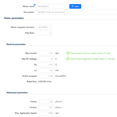

No, I didn't profiled the motor. As currently i am using R57BLB50L2 motor B-MOTOR-PMSMA1 which motor provide by ST. So i thought it's parameter are already tunned.

And Soft Over Current Limit has been auto calculated.
I tried increasing to 5A, 7A. But still getting the same over current sw fault and i can observe that current is reaching to |5| A limit.

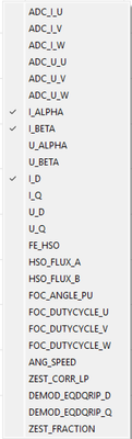

As you suggested, I don't find target current in plot available parameter list.

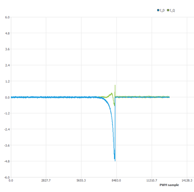

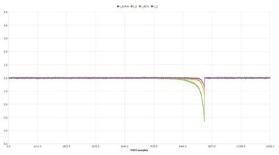

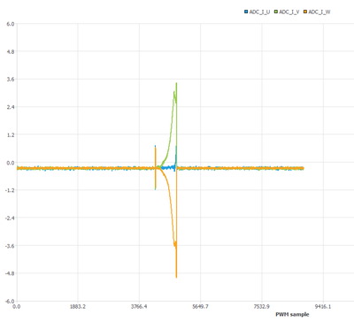

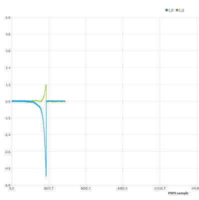

I captured Id and Iq.
Kp = 0.087
Kp = 0.0087

Hello riteshEDC,
The HSO embeds its own Motor Profiler, that is accessible directly from the HSO's MotorPilot GUI. For more information, check out our HSO Startup Guide (via Workbench, click on About -> Documentations -> Documentation -> on the new browser tab, click on HSO Startup Guide)
In Open Loop mode, the target current is the one you set through the GUI, you don't need to plot it. Can you simply switch to Open Loop Voltage, set the target frequency to 0Hz, set the target duties to a few percent, then start. Once current is flowing, set the angle to 0° and see if the D-current is aligned with the alpha-current ? You should have something like this : Ialpha = Id = +something, Ibeta = Iq = 0A.

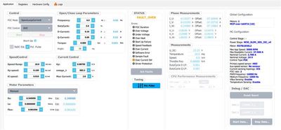

I tried running in open loop current mode as per your steps, but getting the same "Over Current SW" error.

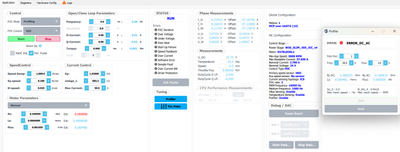

And in your previous reply you suggested to do Motor Profile, But at that time I tried using "Profiler.qml" GUI that's why got error "This Profiler doesn't supports HSO".

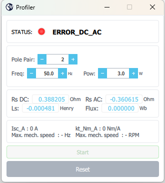

But today i realize that in HSO GUI qml also there is Option for Profiler. I tried to run that but getting "ERROR_DC_AC". May be due to LS and RsAC seems negative.
