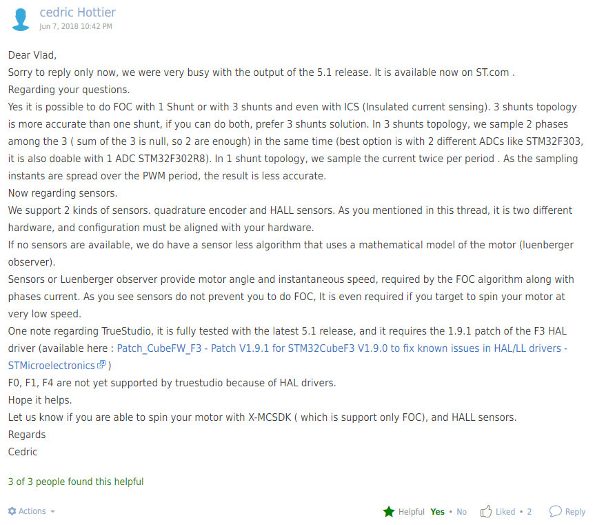

https://community.st.com/0D70X000006SsE0SAK
seems trueStudio is not supported yet due to drive issues.
