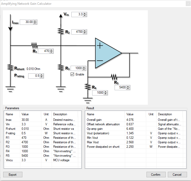

Q:When I go to setup the shunt, I get this, should I stick to default values - making sure it covers my current range or do I need to adjust the gain settings or something else ? I am missing the objective of configuring this.

I really advise you to look at our power boards solution. All our schematics are available for free.
I do not know what is your VBUS, but perhaps you can start with this reference :
the schematic is here :
http://www.st.com/resource/en/schematic_pack/x-nucleo-ihm08m1_schematic.pdf
This board can do both, 3 Shunts 1 shunt FOC , or Six steps. keep the parts that make sense for you .
As you choose a Cypress PSOC4 controller, our workbench tool will be useless for you ...
