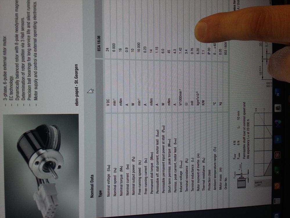

After getting the data sheet for my motor the motor is nearly spinning it is so close.

I take a project and a default motor template SDK5x - STEVAL-SPIN3201 - BullRunning.stmcx then I change all the parameters to suit the motor I am using to do this i follow UM2152 manual line by line.

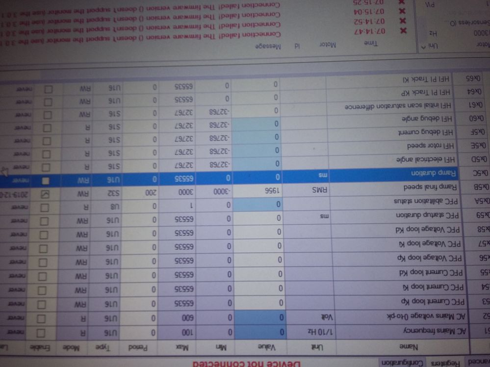

I set the speed voltage with pot and press run the motor attempts and starts spinning several times then stops saying speed feedback error on the motor workbench GUI
I look through all the paramaters and one looks suspiscous
paramater 0x5C ramp duration is set to 0mS I can not find the paramter for ramp duration in any of the header files
Where is the ramp paramater
Also changed the PI KP and KI gains down to try and start it
the motor paramaters are all entered correctly

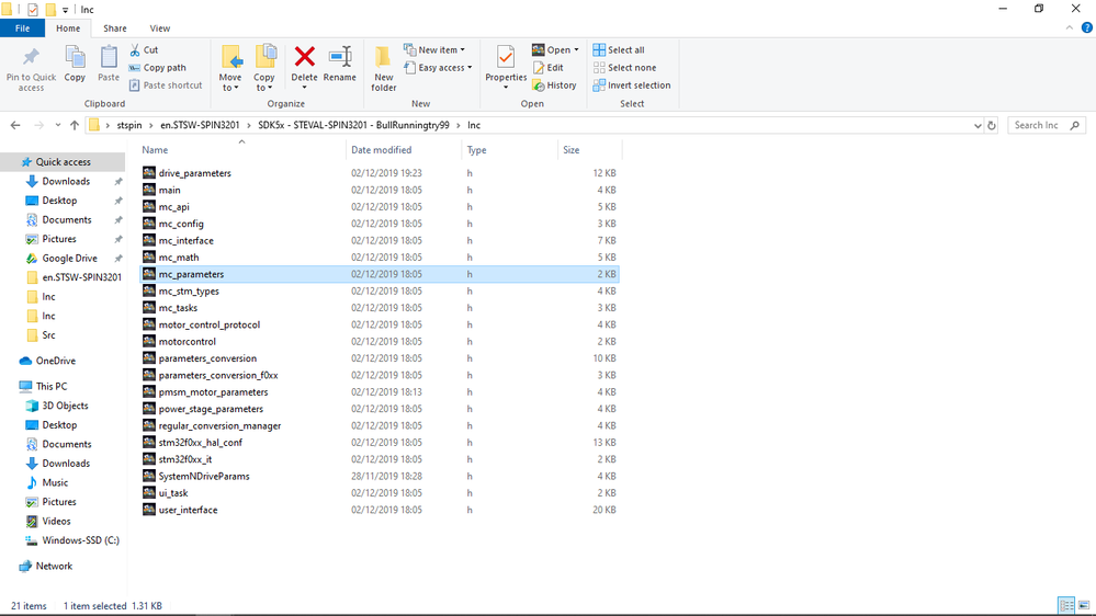

out of all these files shown in the picture which one contains the ramp speed parameter I think because par mater reg 0x5C is set to zero so theres no ramp time and it dosent start
heres the file list
please can anyone suggest which paramater i need to change the motor spins several times over a half second then stops im so close any help wouldbe much appriciated.

Apologies attached is very small zip file this had all the .h files from the INC folder, in my custm STM32SPIN01 Atollic porject
By knowing which parameter I need to change
The motor is so close to running it gets up to a say 30 rpm over 0.5 second then stops
how to make ramp not zero many thanks header files attached in a neat zip file
