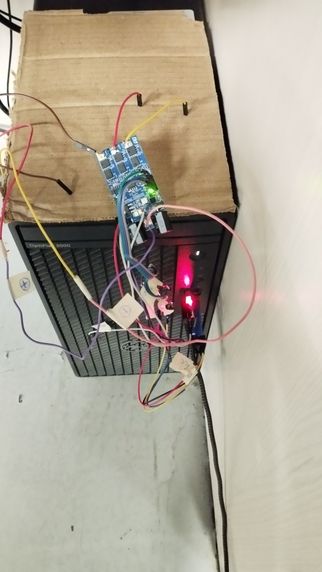

Could you please tell me how you connect the board to your computer ? You can send pictures if you want.
2024-12-17 3:02 AM
I have connected UART and ST Link connections
2024-12-17 3:19 AM
Could you tell me what device you use for connecting the ESC001 to the computer ? Also please focus the picture on the connection between the two.
2024-12-17 3:32 AM
I used "ST Link V2 Programmer For STM8 and STM32" (https://robu.in/product/st-link-v2-programmer-for-stm8-and-stm32/?gad_source=1&gclid=EAIaIQobChMIyYD6gdquigMV3j1ECB2KfiYtEAQYASABEgLi2vD_BwE) for debugging and usb to uart bridge for uart. Connections are same as specified in manual. Even uart is working fine when i am trying to send data through code and output on putty.
