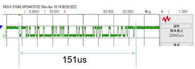

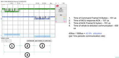

Thus, each packet(14Bytes) should takes about 121µs (The actual experiment result is 151µs.) base on 921600 baudrate configuration.

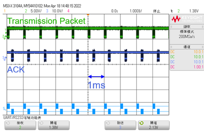

The following waveform was measured at a communication rate of 1 kHz and it is in handshake mode. (Each transmission is followed by a corresponding acknowledge)
Room in on only one handshake transmission.
You can notice that even at a communication rate of 1 kHz, the transmission utilization has already reached approximately 43.9%, based on a baud rate of 921,600.
