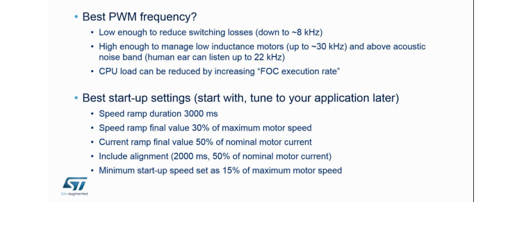

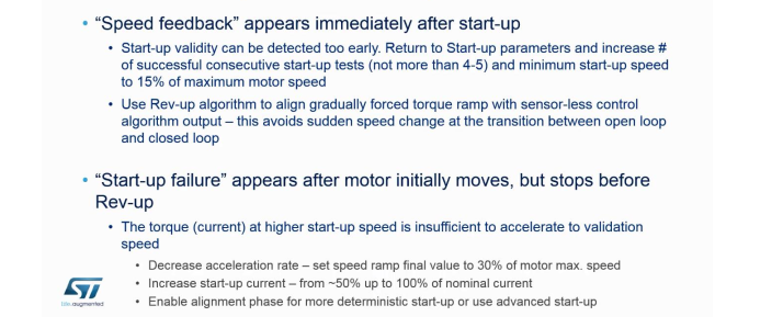

Hey @tasifacij
Here are some screenshots that might help you get a better startup procedure.
please note that speed feedback, startup failure, and over current errors may arise due to hardware issues.
Best Regards!

Hey @tasifacij
Best Regards!
