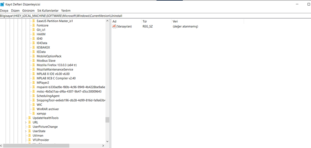

2024-12-20 8:55 AM
There is nothingnamed STM32CUBEMX

2024-12-24 2:30 AM
if nothing concerning CubeMx appears neither on :
Computer\HKEY_CURRENT_USER\Software\Microsoft\Windows\CurrentVersion\Uninstall
nor
Computer\HKEY_LOCAL_MACHINE\Software\Microsoft\Windows\CurrentVersion\Uninstall
this means that the CubeMx installation went wrong.
To go further on the investigation, we need to know which windows OS version do you have on your PC?
