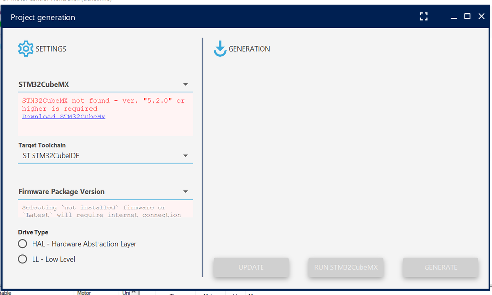

Hi everyone,I have problem about ST Motor Control Workbench.I can ' t generate project.I tried so many things(I installed and unistalled different versions , I changed OS language etc.) but I couldn't do it .Please help.

@ilker07 ,
it seems that the STMC Workbench does not detect correctly the latest version of CubeMx installed.
Can we try to uninstall the Cubemx and reinstall it, and try again please (keeping MCSDKalready installed)?
