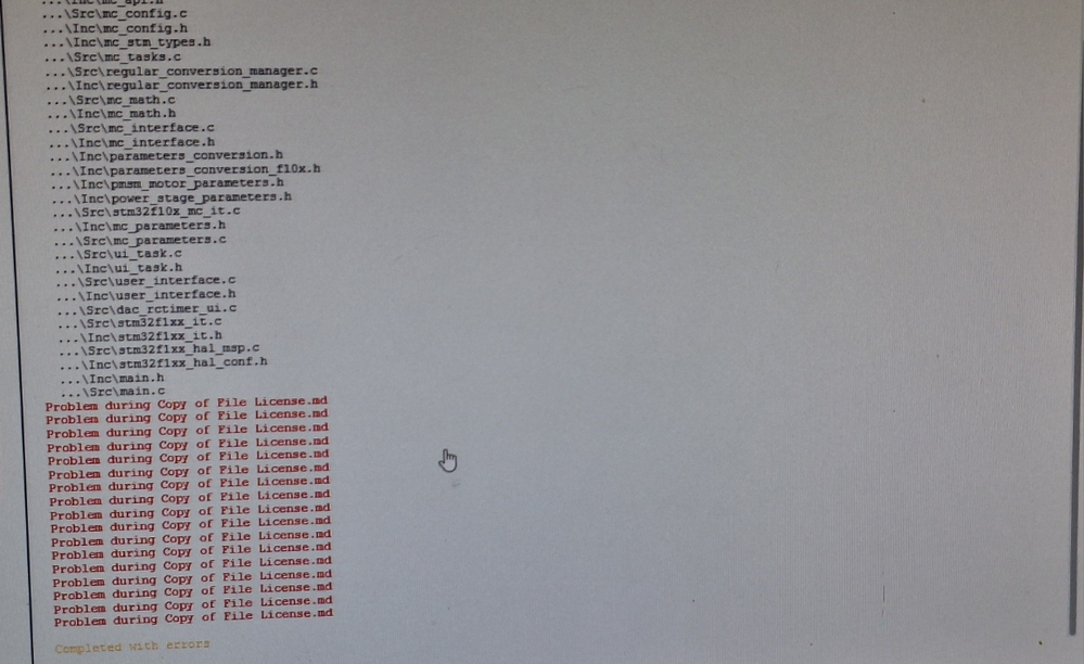

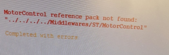

為什麼在從未修改的範例專案生成代碼時會收到此錯誤?

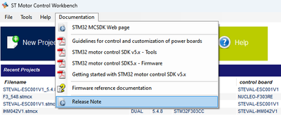

Refer to MC Workbench Release note documentation:
On "V5.4.8 / 30-Nov-2021" chapter, it is mentioned CubeMx version to be used "v6.4.0" and firmware packages versions for each STM32 series.

As the generation has gone up to the main.c file, can you continue with the generated project?

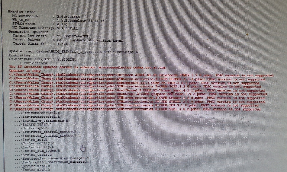

Hi GMA,
Can the red PDSC file affect the project?
Because the pins generated by MAX do not include my options.

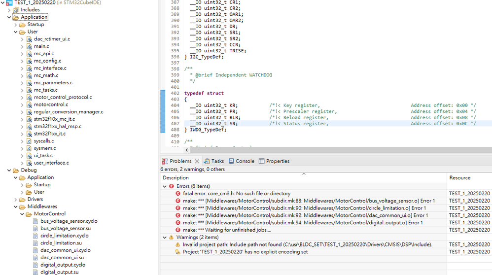

Yes, the main.c is shown in the project, but as depicted, the compilation failed.now?

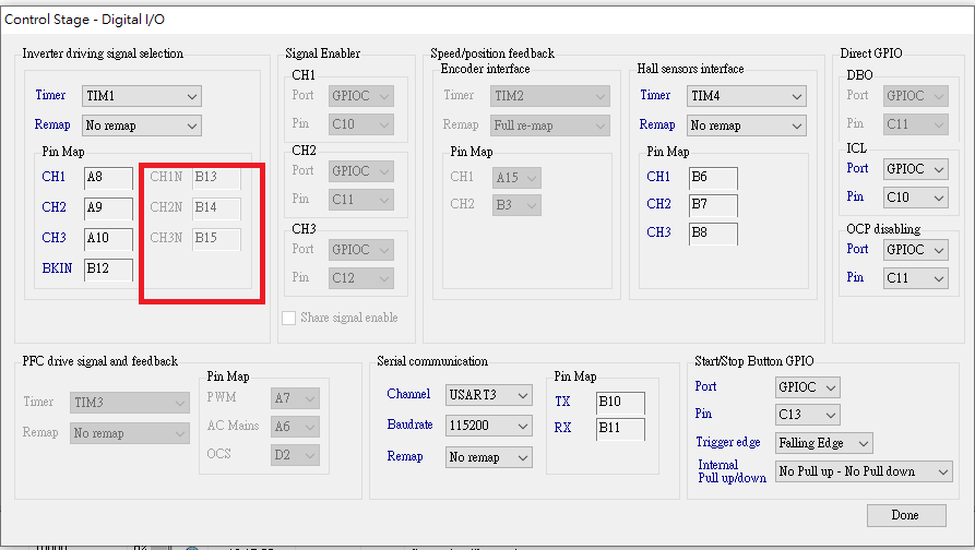

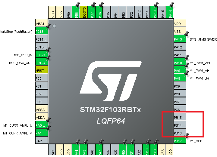

B13/B14/B15 are shown in gray on "Control Stage" window, so they are not used.
2025-02-23 6:23 PM
Hi GMA,
How do I configure uncoLeo F103RB using MCSDK so that B13, B14, and B15 are not grayed out in the Control Stage?
