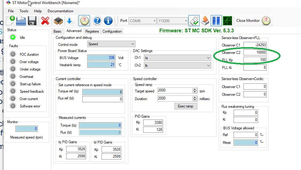

@TCibo I feel your pain! I am having similar issues although today I did get the motor moving by playing with parameters in the motor control workbench. I changed these parameters and I seem to be getting somewhere. Are you getting a fault message on any of those on the left side of the image below?
