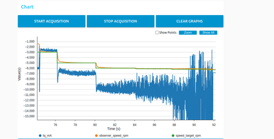

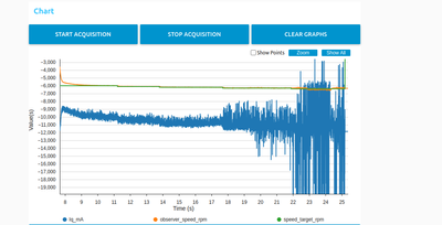

2024-07-11 5:26 AM
I also tried to :
- increase the sampling time of the ADCs
- change the opamp op speed from "NORMAL" to "FAST"
- reduce the gain of the op amp to lower the amplification of noises (at the cost of a lower resolution on my ADC)
The gain reducing seems to give a slightly better solution but mind-blowing.
I join a few graph of current and rpm made with cubeMonitor.
