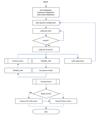

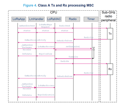

For instance, STM AN5406 (application Note for Wireless Middleware) has these diagrams below, which help the user (of middleware) to understand the design of the middleware and the sequence of the code execution.
But I didn't find this kind of info for the motor control middleware so far.
