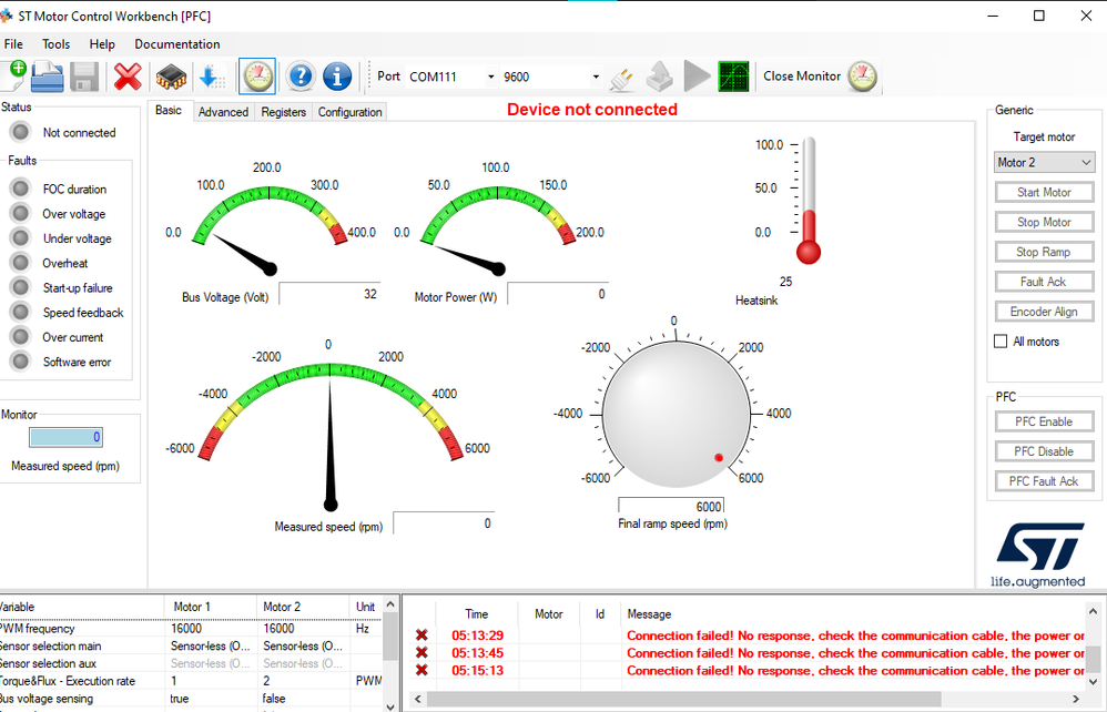

I am working with ctm010v1 got this communication error, Any documents available for communicate the eval-board with pc.
I just done following steps :-
with regards,
JIJO

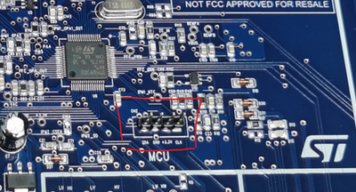

Haha,it's just not true!
There is a mistakenly soldered components on the board.
R99 should be 4k7, but 220R is soldered.
It is an optron pull-up, and the signal is just unable to go to '0'...
Lets see how many surpises exist ot that board...
ST, this is ridiculous!

I have the same problem, but still no solution. I have already tried STLink-V2, STLinkV3, I2C. No connection possible. So I can't upload the firmware.
(I use MCW 6.3 - select the Ribgt board and my motor - have generated the code - everything is fine, except for the upload)
kind regards
