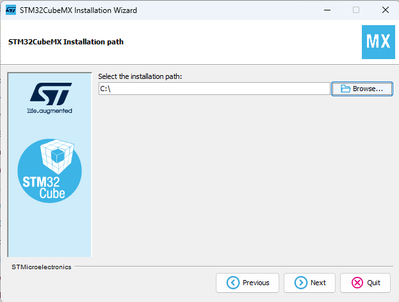

The STM32CubeMX 6.16 tool is available here.
As you mentioned, try selecting a path without special characters.
