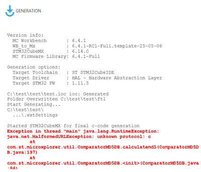

I'm in charge of the motor driver for a new project we've started working on. I freshly installed MotorControl Workbench, CubeMX and the IDE. After setting all parameters in Workbench and hitting "Generate the project" button I get a Java runtime Exception "unkown protocol c". I've hit a wall trying to fix this as there's almost no info about similar issues on the web.

I uninstalled all previous versions of Workbench and MX and downloaded and installed the newest again. I also re-installed the FW package for the G431 and I'm STILL getting this error (see screenshot).
Edit: I also tried making new projects, choosing a predefined pack (everything stock from ST)

Hi @nb_coresight ,
this issue has been identified and should be fixed within next release of STM32CubeMx 6.16.0 which will be available in the coming weeks.
Nevertheless, can you please check with the version 6.14.0 and let us know your status.

Nope, still the same issue
