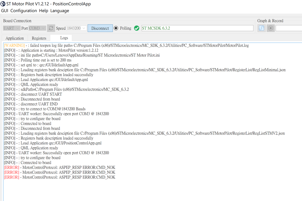

"MotorControlProtocol: ASPEP_RESP ERROR:CMD_NOK" An error code occurs when the ABZ encoder motor runs the Position Control Mode command.

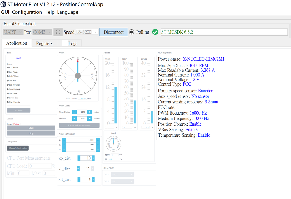

3. Error Code Trigger Description:
When the Target Position Command is sent for the first time, the motor will rotate and no fault will occur.
When the Target Position Command is sent for the second time, this Error Code will be triggered.
When the Target Position Command is sent for the third time, this Error Code will be triggered again.

The "[ERROR] - MotorControlProtocol: ASPEP_RESP ERROR:CMD_NOK" means that your command is not correct (as clicking on the "Start" button once Status already equal to RUN state).
Is ERROR trig at the "Execute Set Position Command" command?
