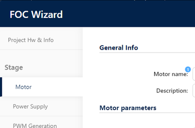

Check your used Motor parameters:
Refer to User Manual documentation available through "Workbench tool">About>Documentations>Documentation>"User manual" tab, "(FOC) Firmware errors" link for error description and management.
