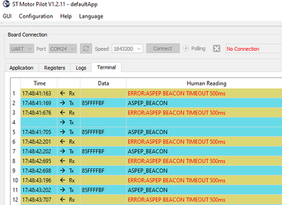

I have a motor control project that I'm testing out using Motor Pilot. If I generate it with FreeRTOS support, Motor Pilot can't connect to the board (the board sends a probably malformed ASPEP_RESP and then it's always a timeout).

Noticed that void ASPEP_HWReset(ASPEP_Handle_t *pHandle) from aspep.c is always getting called.
If I untick the FreeRTOS button in the workbench and regenerate the code (keeping all other settings), then MCP works as expected.

I've regenerated and recompiled everything with 6.3.1, same issue (void ASPEP_HWReset(ASPEP_Handle_t *pHandle) is always getting called if I'm trying to connect with Motor Pilot).
