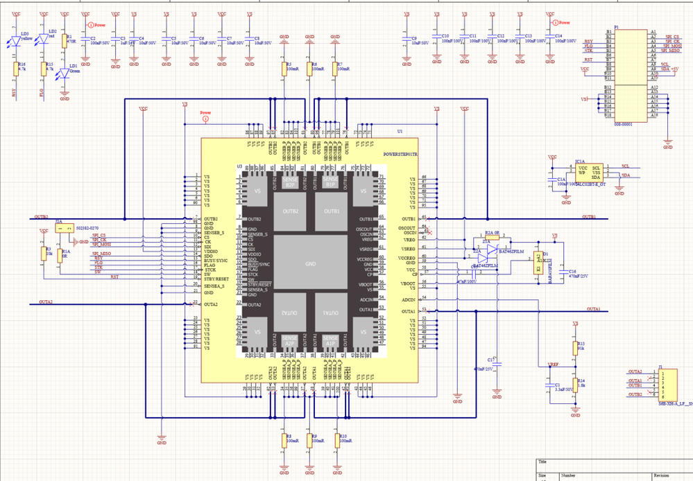

I am using Powerstep01 for stepmotor driving , comminucate with stm32H743 via SPI , and using x-cube-spn3's firmware for testing (IHM03A1_ExampleFor1Motor), but after initial function running , motor can not run. and after reset the power , powerstep01 is alway burned out . below is the schematic , Does someone could help to check what's the issue ? (VS=24V , VCC=3.3V)

I found the pin9 (SENSEB_S)and pin20 (SENSE_A)is dirrectly to ground , do you think this is the key point for the problem?

Welcome @Ellison, to the community!
Thanks a lot for sharing the schematic.
Yes, wiring the current‑sense pins directly to ground is almost certainly the root cause of the failures:
By shorting the sense pins to ground:

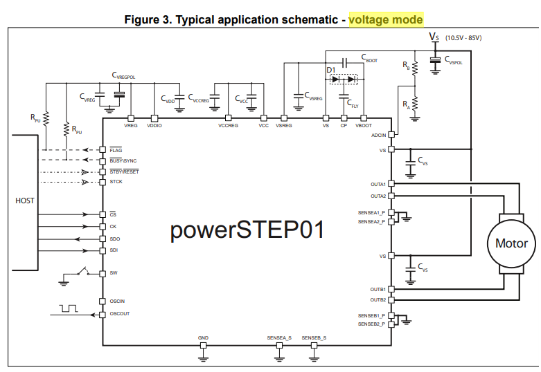

I checked the datasheet , it seems when when sensea_s and senseb_s pin tie to ground could work in voltage mode .

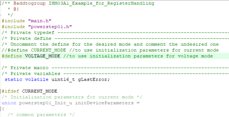

I change the initial code to voltage mode .
the chipset did not burned out . but the motor still can not work .

Right: in voltage mode tying SENSEA_S and SENSEB_S to GND is allowed and should not, by itself, damage the device - provided all other voltage‑mode components (Rs, Ra/Rb, Cvs, boot‑strap network, etc.) follow the data sheet reference design.

Do a minimal test sequence in voltage mode and read back MAX_SPEED, STEP_MODE, KVAL_* and CONFIG to verify they are actually written.

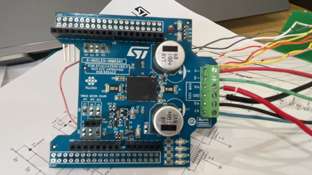

Today , I got one IHM03A1 board for testing , fly wire to my board . but unfortunately , still some issues .
(1)I changed "CURRENT MODE" in the firmware . on the first time power up, It seems everything works fine .and motor could run. below is my test code version :
(2)but after one or 2 times later, it works become unnormal , and the SPI comunication is not correct, and It could not read back the correct parameters in debug mode (using JLINK). some times motor run,some times not . :( .
(3)I thought the hardware of SPI interface is good. (because I could use to drive other brand's motor driver very well) (4) My platform is STM32H743VIT, sysclk is 480MHz, Do you think you could help to give me a simple test code ? so that I could find out what's the problem ,
