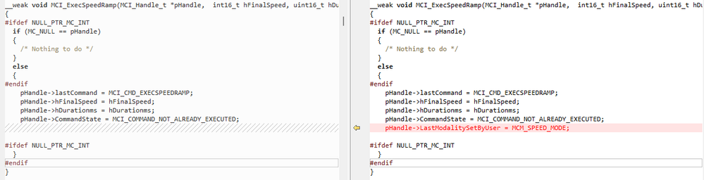

Thank you it runs now after correcting hardware issues, but few concerns is after some rotations for 1 to 2 minutes it gets struck up, sometimes gets problem in starting. Do we have solutions for that?
2023-05-18 1:42 AM
Now I have landed in confusion when you give the last command Mci_execSpeedRamp it does not stay in open loop mode it goes to speed mode, could you please explain me this?
2023-05-21 9:08 AM - edited 2023-11-20 6:34 AM
It is my mistake
