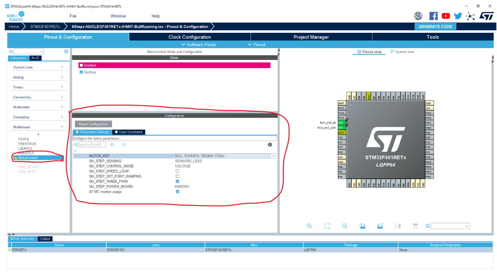

Does anyone know how to add the Motor Control library using STM32CubeIDE or STM32CubeMX as shown below figure? Is it possible in the first place?
By the way, the figure is the output result of Motor Control Workbench.
As you know, the X-CUBE-MC SDK tools only generate code projects for supported devices and evaluation boards. If you don't have the device you are using, it will take more time in migrate similar example code.
If I can easily add a library, I would like to do it.
