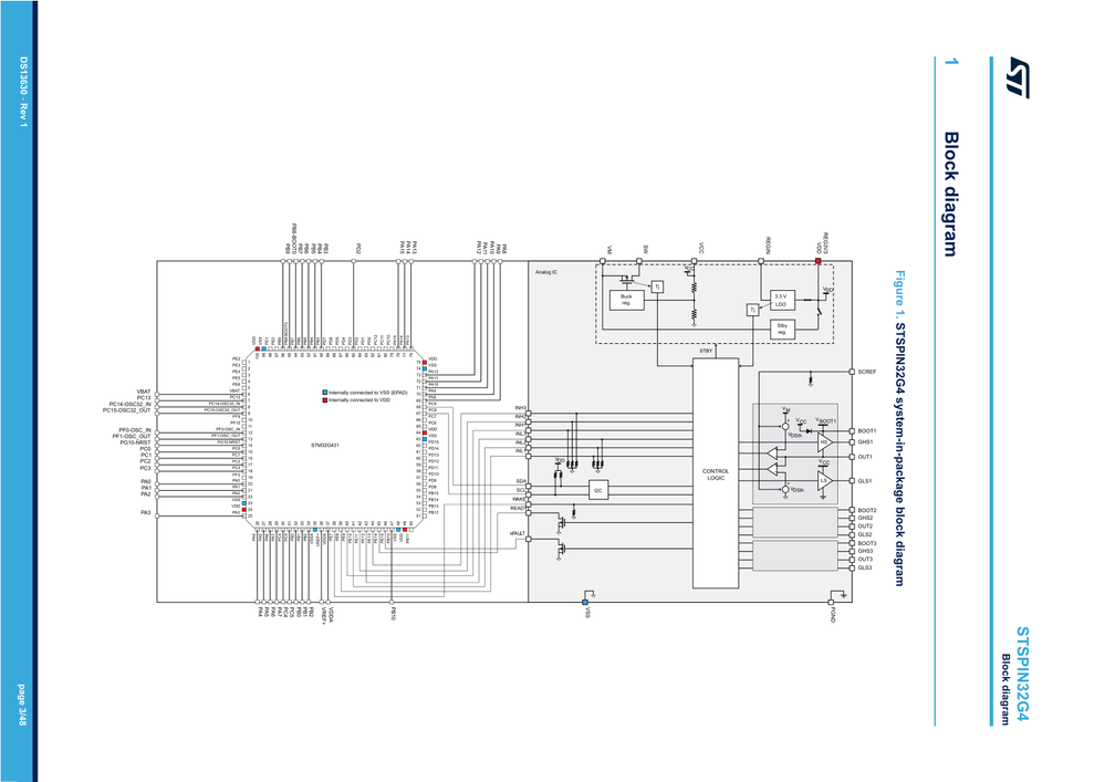

To check if GATE pin of high side MOSFET receives PWM or NOT, We are trying to toggle the High side switch of STSPIN(INH1) i.e GPIO pin PE9 and checked with the oscilloscope.
The pin is not toggled only the voltage 12V is shown on that pin.
My question is, is it possible view the given PWM to the GATE pin of high side MOSFET via microcontroller pin or the PWM logic is controlled by the logic circuit i.e inside of the STSPIN.
Looks PWM lines (PE8..PE13) are inside and not exposed:
2023-05-19 4:37 AM
2023-05-19 9:38 AM
Those signals are interconnected internally inside the package, they are not brought out to external pins.
