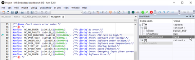

Unfortunately, Workbench 5.4.7 is no more available on ST site (for STEVAL-CTM010V1, example is available with WB5.4.8 or it is available on WB6.2.1) and I cannot check on FW side but could you please check with a debugger if an error has not been trigged internally and not reported to the tool? On WB5.4.8, a table STM[] contains a "fault occurred" variable.
2023-12-19 11:48 PM
On WB5.4.8, a table STM[] contains a "fault occurred" variable. Can you just send me a screenshot where we can see these values in live expressions??
Regards
Vijay
2024-01-05 1:37 AM
Please display STM Table:
Error values definition available in mc_type.h
