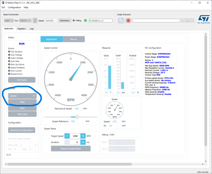

You can try either to add some load on your motor shaft or to reduce drastically your target torque. Finally, to control speed, nothing beats Speed Mode. It is available by clicking on the SPEED / TORQUE button on top of the Start button in the control panel (see image)

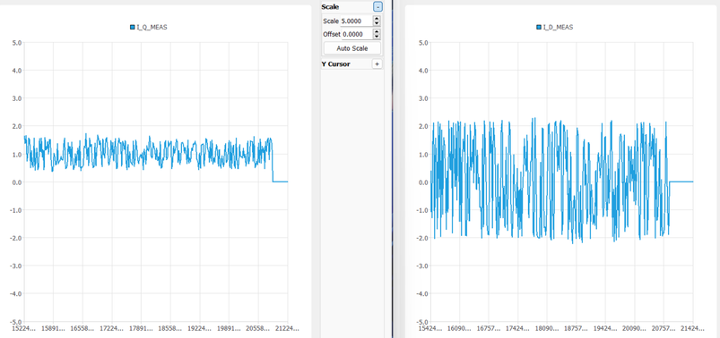

I had the controller on speed mode the entire time. Adjust the RPM on the dial does nothing. I also was monitoring the currents Id and Iq. Both waveforms have sharp peaks and valleys. I don't see how I can precisely control torque with these results. Although, I did notice some performance improvements when I was playing with the PI constants. This also adjusted the speed of the motor though the speed dial still did nothing.
