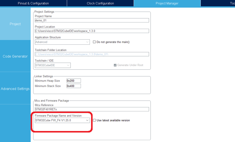

2020-10-28 1:06 AM
Hi @Laurent Ca... , @Karl Hönemann , @Community member ,
I've done the follow steps.
1) Update the fw package to the last one 1.25.1 inside the ProjectManagerTry again but I've the same error
2) Apply the patch called "en.patch_cubef4.zip"
3) Added these lines of code into the "CDC_Control_FS" function inside the "usbd_cdc_if.c" (thanks google).
case CDC_GET_LINE_CODING:
if (length == 7)
uint32_t bitrate = 9600;
pbuf[0] = (uint8_t)(bitrate);
pbuf[1] = (uint8_t)(bitrate >> 8);
pbuf[2] = (uint8_t)(bitrate >> 16);
pbuf[3] = (uint8_t)(bitrate >> 24);
pbuf[4] = 0; // 1 stop bit
pbuf[5] = 0; // parity none
pbuf[6] = 8; // datatype
break;Try again and now it's working !!
I'd like to ask you, in your opinion this is the correct way or is a band-aid solution?
Do you have any other suggestions?
