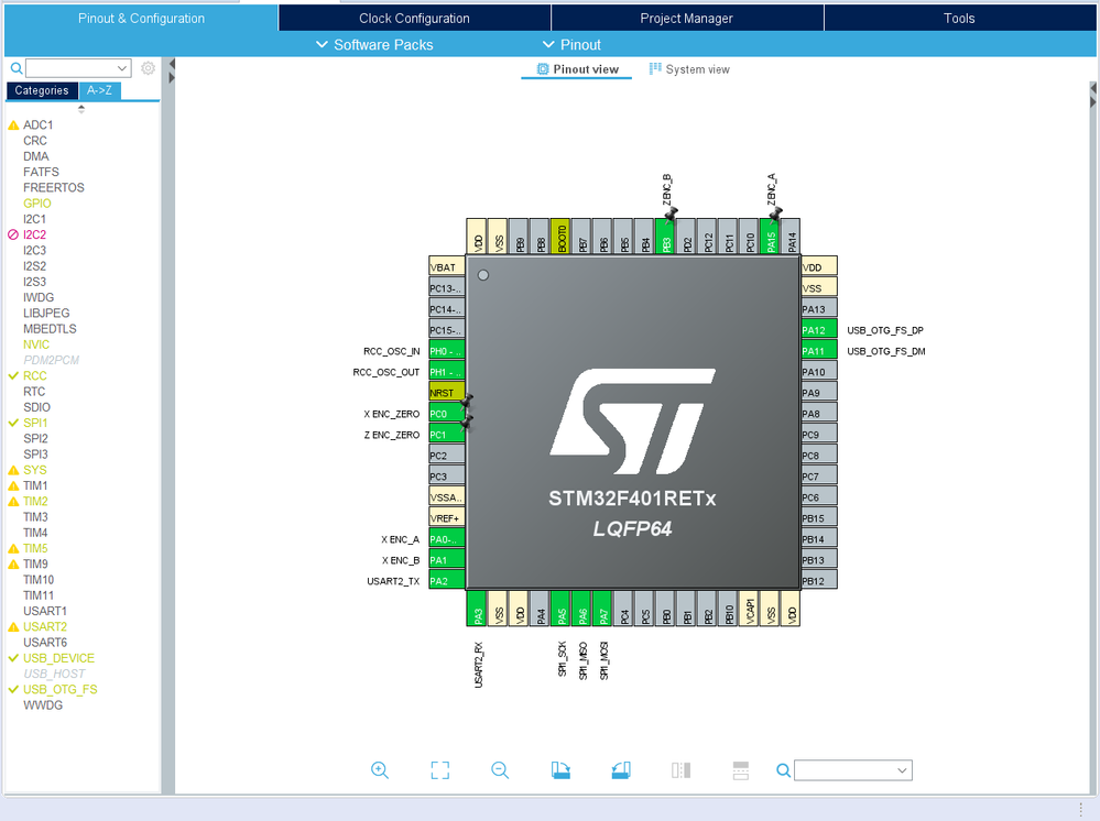

Now I'm trying to integrate this motor example on my project that manage:
- TIM2 32 bit counter (external encoder 1)
- TIM5 32 bit counter (external encoder 2)
- 2 external interrrupt (encoders index to reset the counter values)
- USB OTG used to communicate with a computer as virtual com port
But when I download this new project the firmware hang when I call
BSP_MotorControl_Init(BSP_MOTOR_CONTROL_BOARD_ID_POWERSTEP01, NULL);Obviusly my project without the motor section works fine.

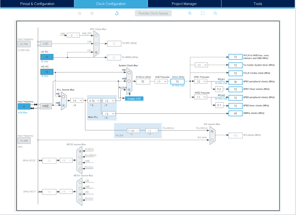

I think there are some mismatch between the the sample motor project and my project configurations.
Eg:
this is the clock config of the motor sample project
void SystemClock_Config(void)
RCC_ClkInitTypeDef RCC_ClkInitStruct;
RCC_OscInitTypeDef RCC_OscInitStruct;
/* Enable Power Control clock */
__PWR_CLK_ENABLE();
/* The voltage scaling allows optimizing the power consumption when the device is
clocked below the maximum system frequency, to update the voltage scaling value
regarding system frequency refer to product datasheet. */
__HAL_PWR_VOLTAGESCALING_CONFIG(PWR_REGULATOR_VOLTAGE_SCALE2);
/* Enable HSE Oscillator and activate PLL with HSI as source */
RCC_OscInitStruct.OscillatorType = RCC_OSCILLATORTYPE_HSI;
RCC_OscInitStruct.HSIState = RCC_HSI_ON;
RCC_OscInitStruct.HSICalibrationValue = 16;
RCC_OscInitStruct.PLL.PLLSource = RCC_PLLSOURCE_HSI;
RCC_OscInitStruct.PLL.PLLM = 16;
RCC_OscInitStruct.PLL.PLLN = 336;
RCC_OscInitStruct.PLL.PLLP = RCC_PLLP_DIV4;
RCC_OscInitStruct.PLL.PLLQ = 7;
if(HAL_RCC_OscConfig(&RCC_OscInitStruct) != HAL_OK)
MyErrorHandler(0);
/* Select PLL as system clock source and configure the HCLK, PCLK1 and PCLK2
clocks dividers */
RCC_ClkInitStruct.ClockType = (RCC_CLOCKTYPE_SYSCLK | RCC_CLOCKTYPE_HCLK | RCC_CLOCKTYPE_PCLK1 | RCC_CLOCKTYPE_PCLK2);
RCC_ClkInitStruct.APB1CLKDivider = RCC_HCLK_DIV2;
RCC_ClkInitStruct.APB2CLKDivider = RCC_HCLK_DIV1;
if(HAL_RCC_ClockConfig(&RCC_ClkInitStruct, FLASH_LATENCY_2) != HAL_OK)
MyErrorHandler(1);
}This is my clock config auto generated by STM32CubeIDE
__HAL_RCC_PWR_CLK_ENABLE();
RCC_OscInitStruct.PLL.PLLM = 4;
RCC_OscInitStruct.PLL.PLLN = 72;
RCC_OscInitStruct.PLL.PLLP = RCC_PLLP_DIV2;
RCC_OscInitStruct.PLL.PLLQ = 3;
Error_Handler();
if (HAL_RCC_ClockConfig(&RCC_ClkInitStruct, FLASH_LATENCY_2) != HAL_OK)
Error_Handler();
}I've also welded a XTAL 8 Mz + 2 capacitors on my NUCLEO F401RE and cut off the ST-Link debugger.

2020-10-15 7:50 AM
The motor users in my experience are not heavy forum participants.
If there are issues with the clocks you need to make sure they are starting properly, and not going into Error_Handler()
Zeroing the local/auto variables is strongly suggested as they will otherwise contain random junk.
Cutting of the ST-LINK is going to make debugging more difficult. You really need to inspect the state of the MCU and peripherals to see exact where it has stopped, if it has actually crashed or faulted, or is simply waiting for a response from a peripheral that's not being clocked, etc.

2020-10-15 8:02 AM
I think, this is just a problem of conflicting Pins.... I don´t know much about the used Nucleo-Board (esp. the pinout...), but that´s, where i would begin to search. There are just a few possibilities: first wrong SPI-settings (SPI is used to communicate with the expansion board) and second: forget about the step-signal pin (not used in examples) and maybe also about "busy" and/or "flag". For these two pins: just delete the according initialization code and especially the Interrupts ! The Flag Interrupt is fired at startup and there´s a high chance of being the cause for the crash. Give it a try and if your project works... you´re on the right way ;)
/Charly
P.S.: check the pinout settings in the ihm03a1 example: You need SPI-pins, correct SPI-setup (parameters) and maybe (if still available in your hardware) flag and busy - pins correctly configured. Leave the rest (clock settings and so on) untouched in your project. Then merge just the libraries, example code from mainloop and errorhandler (also in main.c of example), as well, as according interrupt handlers from stm32f4xx_it.c
