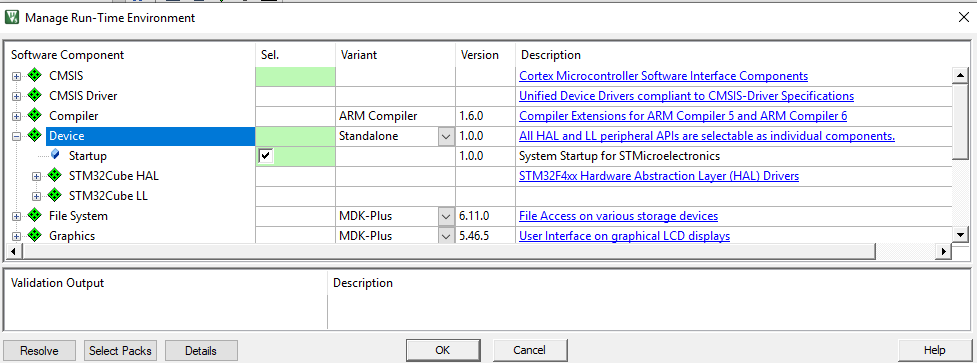

Hello @Ryada.1​ ,
in addition to set the device as "Standalone" in the Run-Time Environment, verify that the "StartUp" option is checked inside "Device".
0693W0000059Ly1QAE.pngThen press Ok in the window and Build the project.
Let me know if this time we fix the error ;)

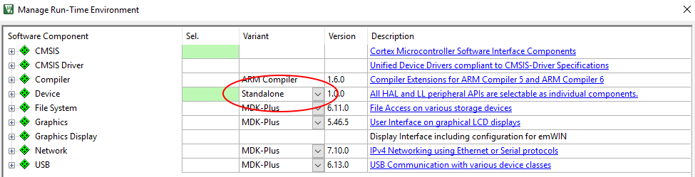

Hello @Ryada.1​ ,
are you using Keil IDE?
If yes, you have to set the device as "Standalone" in the Run-Time Enviroment (Project->Manage->Run-time Environment) as shown below:
 0693W0000058yftQAA.pngLet me know if you solved the issue, if yes please "select as Best" my answer.

Thanks sir for replay yes i am using keil
Ryada.1
Associate II
i did as same you suggested but problem still remain same
Hello @Ryada.1​ ,
If you feel a post has answered your question, please click "Accept as Solution"
Ryada.1
Associate II
thanks for reply sir problem solved thanks a lot sir
