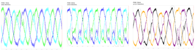

There are two problems. The first is that the phase currents are not as neat and harmonic as I might wish, the second (and main problem) is that once in a while every 10 seconds or so I see this iregularity:
The three phase currents:

I have investigated the samplings cases for different PWM frequencies and excecution rates.
10kHz, 1 exec. rate
20kHz, 2 exec. rate
15kHz, 1 exec. rate
30kHz, 2 exec. rate
At lower PWM frequencies (10kHz & 15kHz, at intermediate load) ADC sampling is only done at half_pwm point (the common case). The timing for the ADC looks good. Still there is noise in the phase currents.

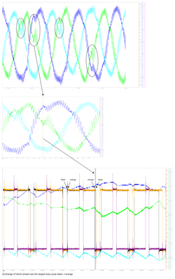

I have further investigated the noise at 15kHz, 1 exec. rate
I toggle a pin at the common sampling case to illustrate that this samplings case is exclusively used (can also be seen in the ADC timing as you mentioned)
(Red is the toggled pin)
ADC Timing is verified by toggling another pin at ADC start and DMA finish.
Blue is the debug pin
Other signals are phase voltages
The noise/distortion correlates with when the phase currents cross each other. Every time this happens the phase current with the largest duty cycle exchanges and this is the assumed cause of the noise I see.
What could this have to do with the phase current noise in the later PWM periods?
Maybe it is HW related, I am unsure

2025-01-10 5:12 AM - edited 2025-01-13 10:56 PM
Hello @Gael A,
For a given electrical speed, the frequency at which the max duty window is switched is the same, whatever the PWM frequency. I suspect that higher PWM frequencies are subject to other sources of noise as well.
This was the reason for choosing to debug the lower PWM frequency (at 15kHz) because it had least distortion.
OBS: I should have show equal amount of periods from the three tests, but realised it late. The message shines through anyway, at 15kHz there is least distortion
