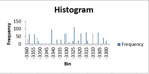

I need to withdraw my question. I collected more data and plotted a histogram on over 1000 samples taken at 1ms sample rate. The table is shown below
I think my problem is if I sample at the motor electrical rate of 5ms (6 pole pair) I get an aliasing effect and only get sample values 3328 and 3334. Is there any documentation on the procedure SPD_GetAvrgMecSpeedUnit ? It simply returns a pointer pHandle->hAvrMecSpeedUnit. I cannot find where this is updated and I can not find any information on the buffersize it is averaged in.
