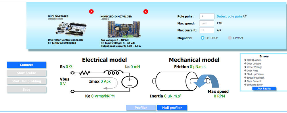

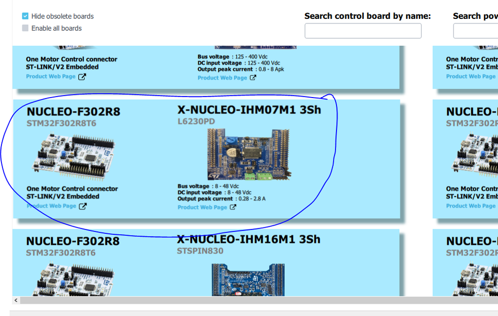

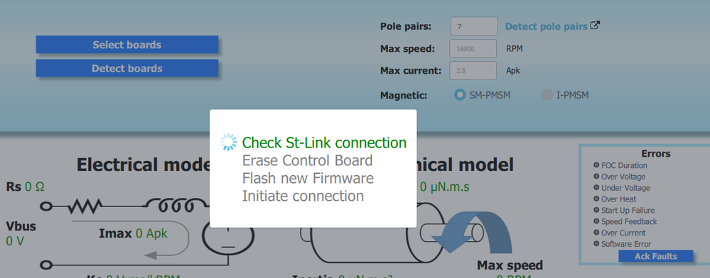

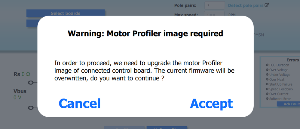

I'm trying to use the Motor Profiler software through my Motor Controller SDSK 6.1.1. When I launch the profiler, I Select my boards - Nucleo-F302R8 and X-Nucleo-IHM07M1 3Sh. Then I set the motor parameters to match my motor Bull Running BR2804. When I then hit Connect I get a warning to update the board firmware. I select Accept and then the process gets stuck forever on the "Checking ST-Link connection" step. What might be the issue here?

The solution on this post helped. I reinstalled the SDSK 6.1.1 at a different location than the default in Program Files.
