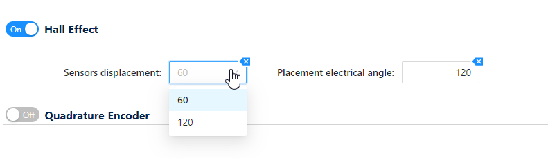

I am trying to use 6-step sensored control. I have a 3-pole pair (6 permanent magnets) motor. The hall sensors are placed 40 degrees apart mechanically so that I get 120-degree electrical spacing. The V5 and V6 MC SDK only support 120 and 60 mechanical degrees for hall sensor placement. I am wondering if this is contributing to my problem below.

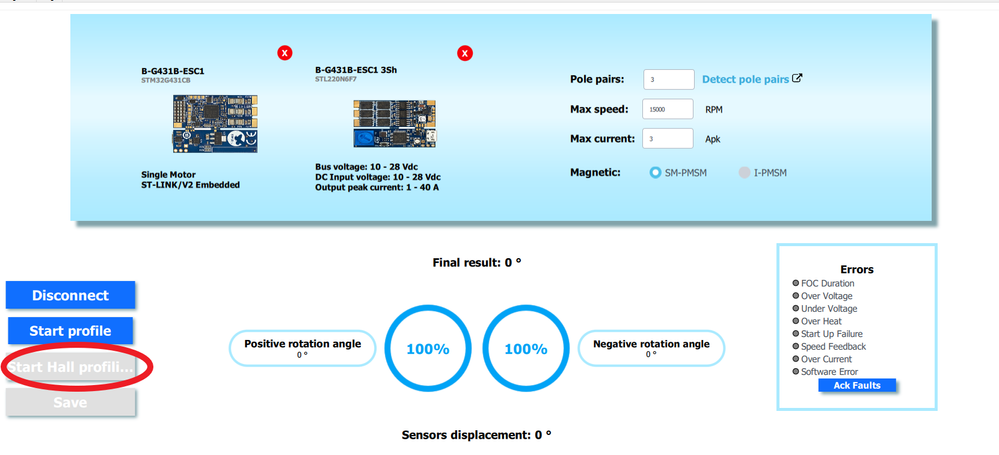

I see V6.1.1 has hall sensor built into profiler. I tried that, but problem is its greyed out.
Also, motor profiler was hard to get running see below:

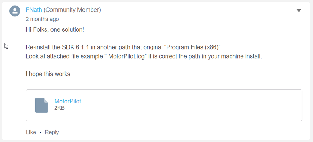

Profiler gets stuck re-programming dev-kit as described here:
Profiler solution fix:
https://community.st.com/s/question/0D53W00002A1SntSAF/st-motor-pilotprofiler-will-not-connect
