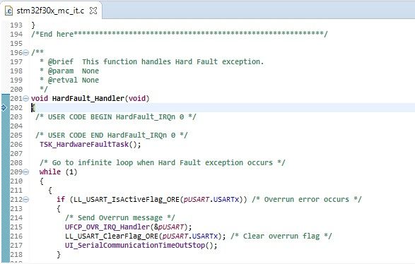

While the TrueSTUDIO debug hangs at the "HardFault" function:

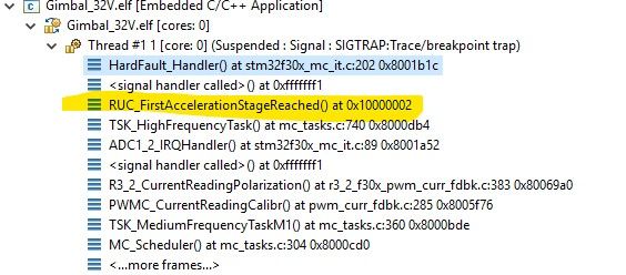

Looking at the "Thread" we see that the function that generated the HardFault should be "RUC_FirstAccelerationStageReached":
But at this point I don't know what to do: I expected everything to work well without a hitch.
