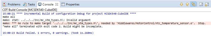

When I launch the "build" it ends WITHOUT errors. but when I start Debug there is still an attempt to "build" but this error occurs:
2019-11-25 8:16 AM
use System Workbench for STM32 (SW4) and FW V1.11.0 !
